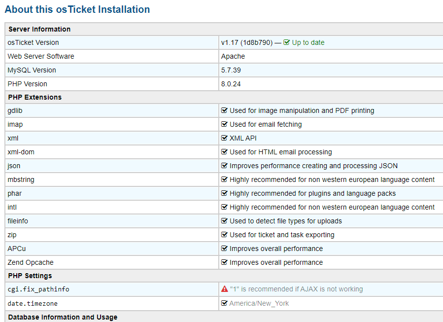

                  This is my system info:
