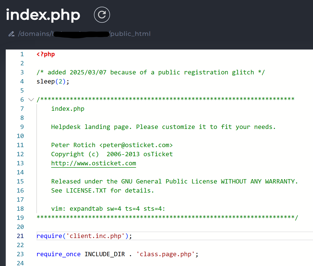

I got to thinking about this and I didn't see where any of that would affect the problem. Since the authentication is working it is just the code not handling the session correctly. I ended up running across another thread (https://forum.osticket.com/d/95841-user-login-issue/29) and the suggestion here has almost totally solved the problem
Add this line to the top of the index.php and tickets.php files, before any other php code is processed.
sleep(2);
For me I added it right under the comments at the top but before the include statements. If you are not using OAUTH2 then you only need to add it to the tickets.php file. Since OAUTH2 redirects to the index.php file, it has to be there too for that to work.

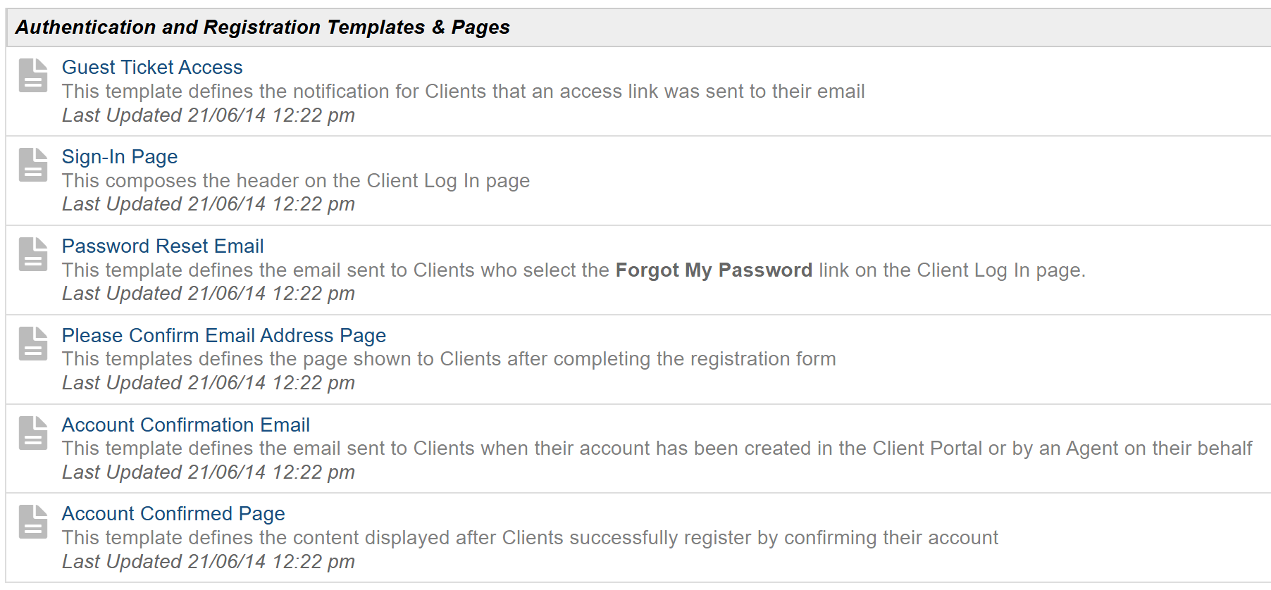

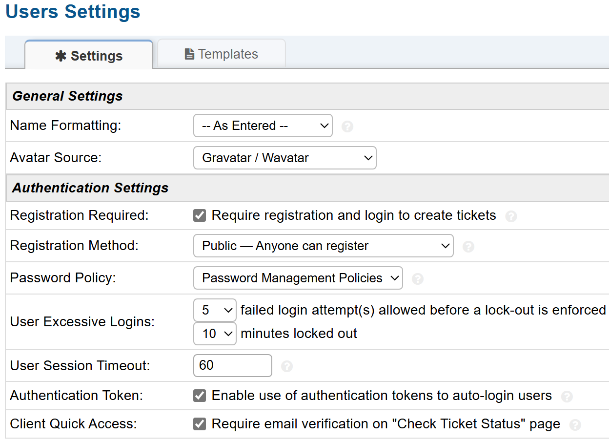

              Well being that it works on the new install you did I’d compare settings to see what’s different. Not only system settings but templates, sever settings, etc.

                glienhard - I've tried your fix, perhaps I'm placing in the wrong location. I placed it here on both tickets.php and index.php

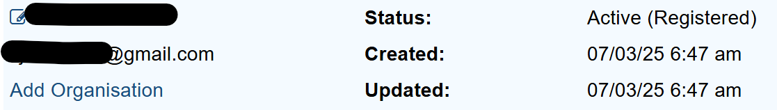

                @KevinTheJedi - The weird thing is that the registration works, the end user is shown the next page advising them to check email. But when they click the link in their email it takes them to the registration page again.
                However in osTicket I can see that they are registered. But the password they set doesn't work.
                You mentioned looking at templates. They are pretty much stock standard. I can't remember editing them at all.
                  sjswarts the sleep statement needs to go on the pages that are redirected to after login (open.php tickets.php view.php). I did also include it on both index.php and login.php in the beginning but I don't think it needs to be there. I put the sleep right after the opening comments of the file, before any of the required files are declared.

                  [unknown] - I've followed your advice. Thank you. Although I changed the sleep time to 1 second instead of 2.
                  I've placed it in:
                  public_html\index.php
                  public_html\login.php
                  public_html\open.php
                  public_html\tickets.php
                  public_html\view.php
                  It is now working as expected. Which is weird because a fresh install also works without the sleep code.
