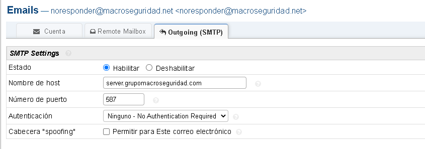

            Hello, I've just configured SMTP with my no-reply account in osTicket.
            With that 'No Authentication Required' I managed to make the changes succesfully:

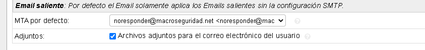

            I've also change that option 'Default MTA' setting my no-reply email.
            However, I'm still receiving all the emails with that "This is a message in Mime Format. If you see this, your mail reader does not support this format." Don't know in what I failed, maybe in that Authentication option, but i'm stuck right now.

            What is "server.grupomacroseguridad.com"? Or better, is there an SMTP server on this machine?
