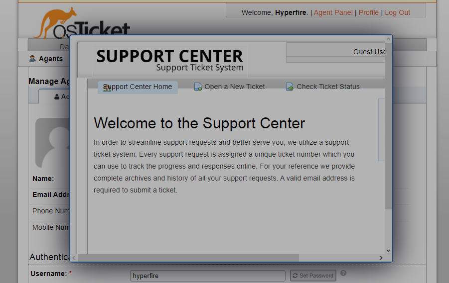

When attempting to set a client's password in the admin panel, i get an Uncaught TypeError: $.toggleOverlay is not a function error. The overlay also shows like this.

    You are using NGINX which is not fully supported out of the box - it requires extra NGINX config. You can search through older discussions on this Forum to find working NGINX configs.

      KevinTheJedi I've tried a few and they haven't worked out, same error.
      I'm confused as to why the server software would cause a function not found error.
        Hyperfire
        Normally you wouldn't have to worry about these things using the webservers listed in the pre-requisites (Apache, LiteSpeed, and IIS). These webservers are fully supported out-of-the-box and all the rules are included with the software via the various web.config and .htaccess files. With NGINX however they do things differently and don't allow included files instead you have to make a site config and include everything there. When using osTicket with NGINX the rules are very important. If some of the rules are missing/not working then some functions and content may not be included properly. For example, things like popups (like in your screenshot) we make an AJAX call to get the popup content and especially with Forms we return the raw HTML which may include additional, required JS functions, code, etc.

        There are some good threads on the osTicket github where people discuss using NGINX as a webserver and the configuration changes that they made to make it work. Take a look at some of the issues people post and use search and you might find an answer.
