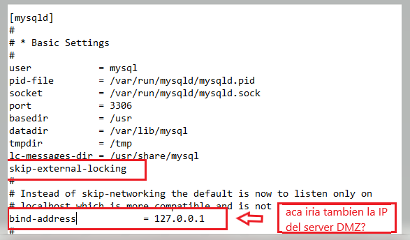

But that doesn't mean that you gave the user permissions to connect from a server outside of the server that it is configured on.
Check the my.cnf bind-address.
