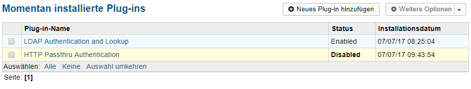

I also just discovered this:
It seems HTTP passthru Authentication is disabled, I don't know why.
