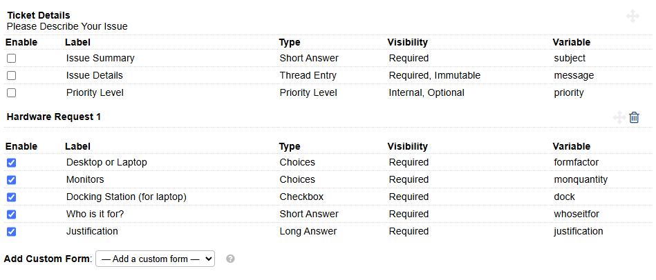

However, it only fixed it for help topics that came with the installation. I.E, the vanilla ones:

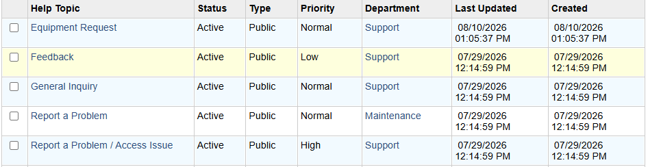

I found this out by testing on the original instance with our custom equipment request help topic with its custom form, seen above in post 32, and on the replicated help topic on the test instance.

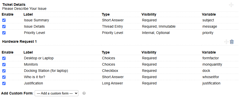

For some reason threading works when I change the help topic to include the original three Ticket Details fields:
Versus what the help topic looks like on the original OSTicket instance:

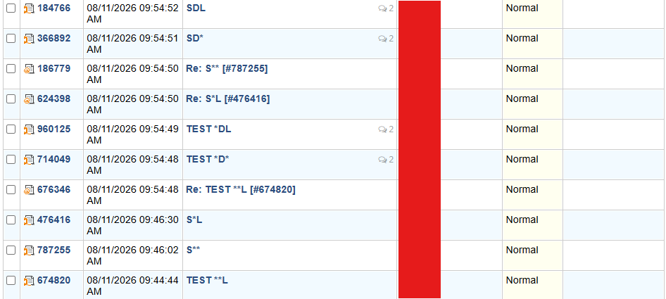

I also did a battery of tests and found that you NEED to have the Issue Details field in your ticket:
For reference: SDL means Issue Summary, Issue Details, and Priority Level.
