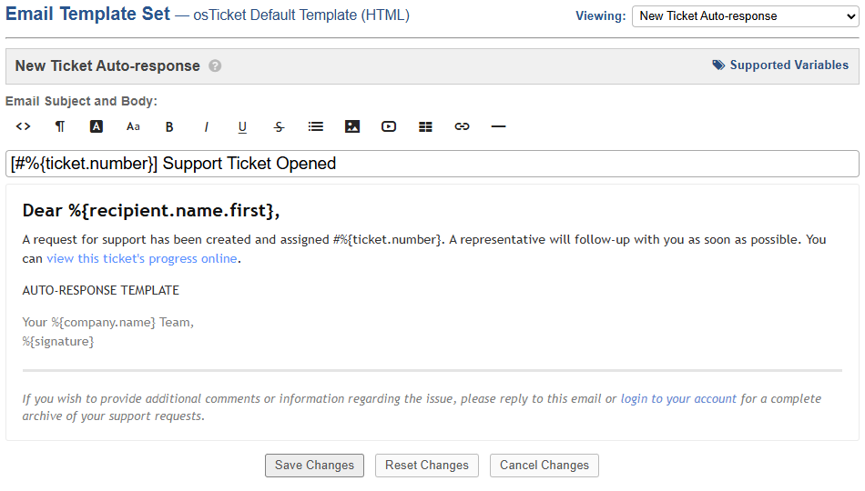

I barely touched the template, only moving the ID portion to the beginning of the subject line.

That's the template.
