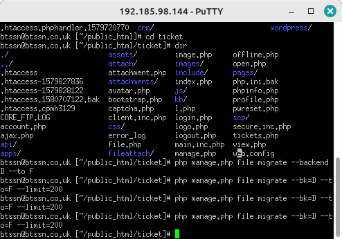

So hostgator sorted out ssh on sub domain
see attachment
here is main directory
Great, now you can run the command I posted above to get more information on the migrate command:
To migrate from database to filesystem simply run:
php manage.php file migrate --bk=D --to=F --limit=200
You will need to run this quite a few times to migrate all the attachments. You do not want to run without a limit.
so here is output now i know why i did not become software programmer
which path do i type ?
Here is myphpamdin driectory using cpanel
Something might be failing as it’s supposed to return something like "Migrated X Files". You can edit your bootstrap.php file and set both display_errors and display_startup_errors to 1 and rerun the command to see if it outputs any errors.
Actually first try lowering the "--limit" to like 10 and see if it outputs something. If not then do the above.
