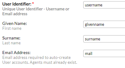

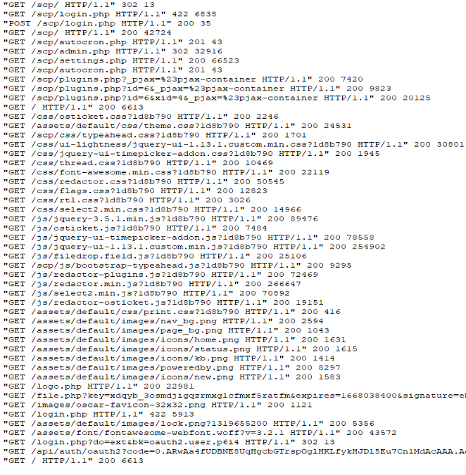

Also trying to setup OAUTH. Got it connected and it launches login screen. After login from Msft, get invalid path error looking for /api/auth/oauth2. Which shows in the error logs but still no indication why. Looking at the server under the htdocs folder there is an /api folder but no /auth subfolder. On the setup screen, it has the server/api/auth/oauth2 path in the redirect URI.
Any thoughts on what I'm missing or places to check to get primarily OAUTH working?
