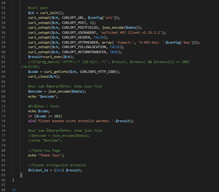

Hello guys,

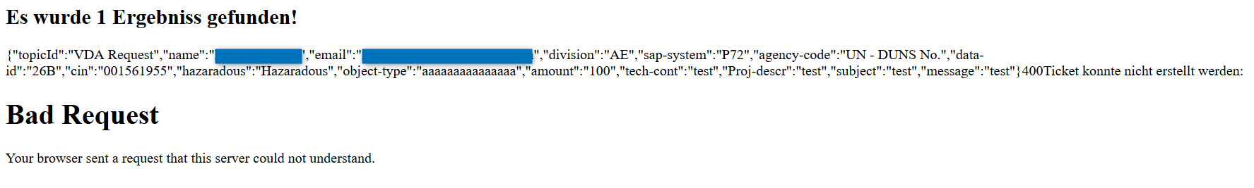

I've' written a custom form to be used for open tickets. I have created an API key in the OST and a script via PHP that passes the fields of the form via POST as JSON. When I run this I get the error message "400 Bad Request. Your browser sent a request that this server could not understand". I also looked in the error log files but couldn't find anything that helps me. I also output the JSON code and the content is also there as it should be passed. On my private laptop I have the same procedure via the local server and there everything works. Does anyone know what could be causing the error code 400?
