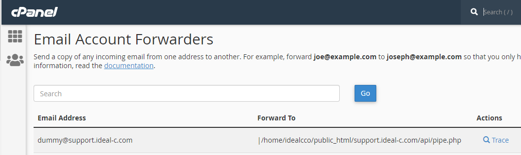

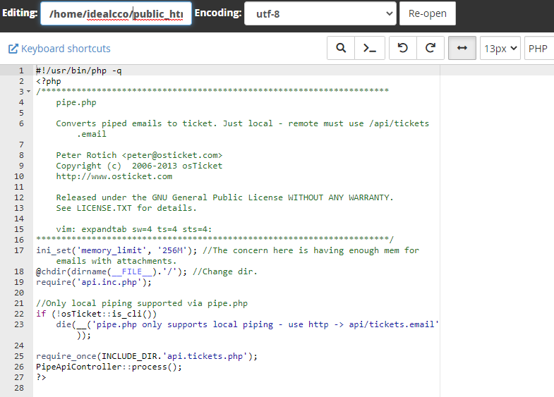

I have created an email forwarder in CPANEL from the email address to the path to pipe.php in my server.

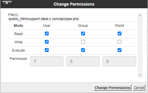

The pipe.php permission has been modified from 0644 to 0755.

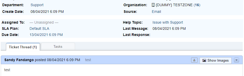

I made an email and send to the dummy email address.
After a while, a ticket has been made successfully in the osTicket system.

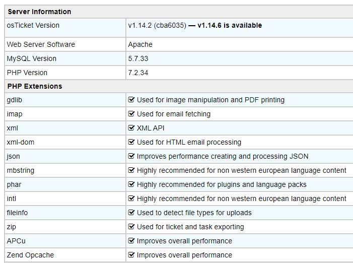

The current osTicket specification:
No modification done to the osTicket.
