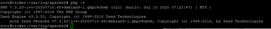

The information pane in osticket shows I'm running PHP 5.6. From the cli, php -v returns that I'm running 7.3.
I tried to remove php5 and after that, nothing worked, so I assume that I did something wrong with the php7.3 install?
