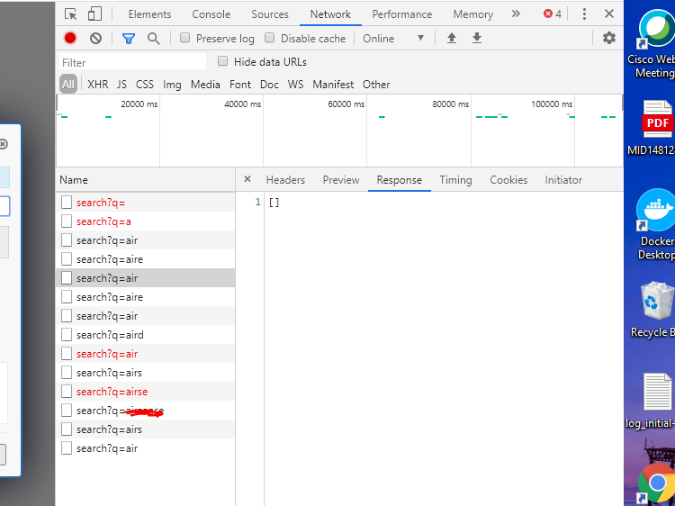

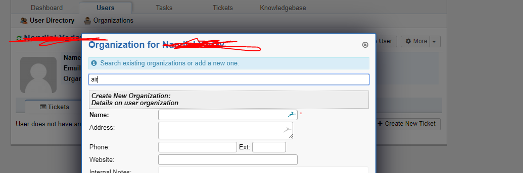

Hello my dear FOlk: i found the same problem in adding the organization:
Starting from this week I will try to install locally and see if I can reproduce the error....no idea for now 🙁

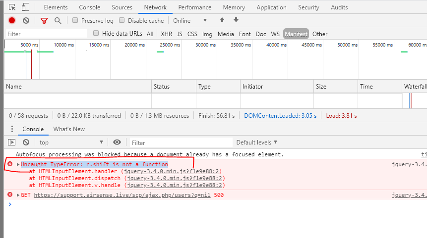

I add some more extra info. Today I tried to replicate the error local and it seems to work...online whit the host I am using I get this error:
So I solved moving the tool in Azure (App Service, with PHP 7.3 aunder an ubuntu virtualized machine). Now it works...no way to solve it due to the fact that locally was properly working and remotely in the host offered by united-domains was not.
