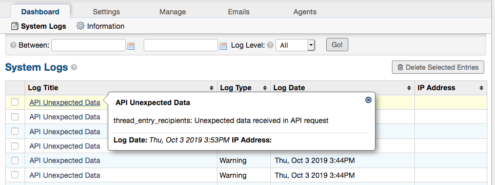

We see this error in the php error log quite often.
[03-Oct-2019 05:39:33 UTC] PHP Fatal error: Uncaught ObjectNotUnique: One object was expected; however multiple objects in the database matched the query. In fact, there are 2 matching objects. in /osticket/include/class.orm.php:1355
Stack trace:
#0 /osticket/include/class.orm.php(606): QuerySet->one()
#1 /osticket/include/class.search.php(534): VerySimpleModel::lookup(Array)
#2 /osticket/include/class.signal.php(98): MysqlSearchBackend->IndexOldStuff(NULL, Array)
#3 /osticket/scp/autocron.php(74): Signal::send('cron', NULL, Array)
#4 {main}
thrown in /osticket/include/class.orm.php on line 1355

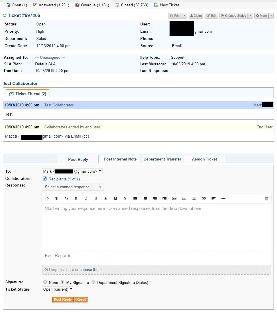

This is an example of what I was expecting to see in v1.12. This screen shot is from our old version 1.9.14
I hope that's enough information to start with.

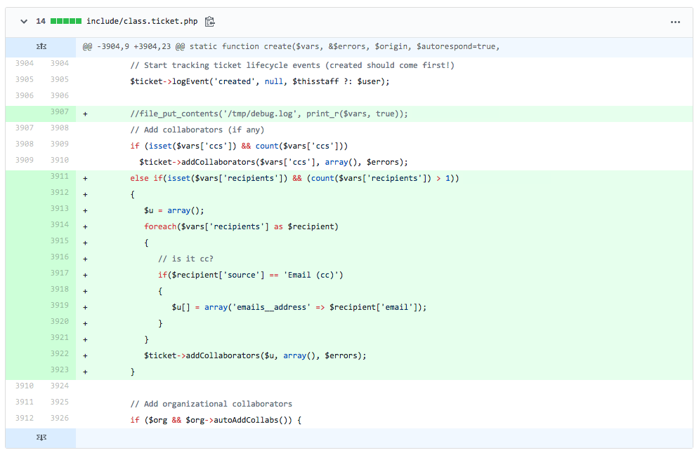

Okay we did a bit of digging and this code change seems to have fixed the issue for us.
If you can see any issues with this change please let us know. This commit was to our own private git repo.
This code change seems to be only working for CC addresses of users who are already in the OSticket users table. Will need to do some extra work to figure out how to add collaborators who may not already have an account.
