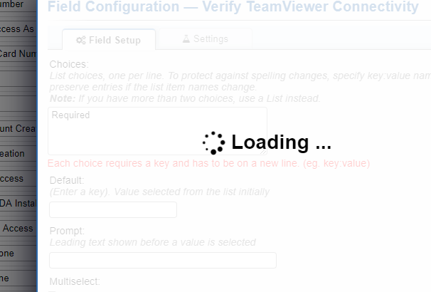

Since we upgrades to 1.12.x, anytime I try to save in the "config" section of a form it stays on the "Loading..." page and does not ever save. I can add items to the forms, but not configure them.

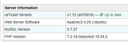

Environment details? Version of osTicket?

Read the error in the modal...it says: Each choice requires a key and has to be on a new line. (eg. key:value)
All you have to do is make keys for each of your values.
Kevin sayd:
KevinTheJedi Each choice requires a key and has to be on a new line. (eg. key:value)
From your screen shot, the information that you input is not in the proper format the error says and @KevinTheJedi told you to use.
key:value
you have: Required
Required
Seems like you only have a value.

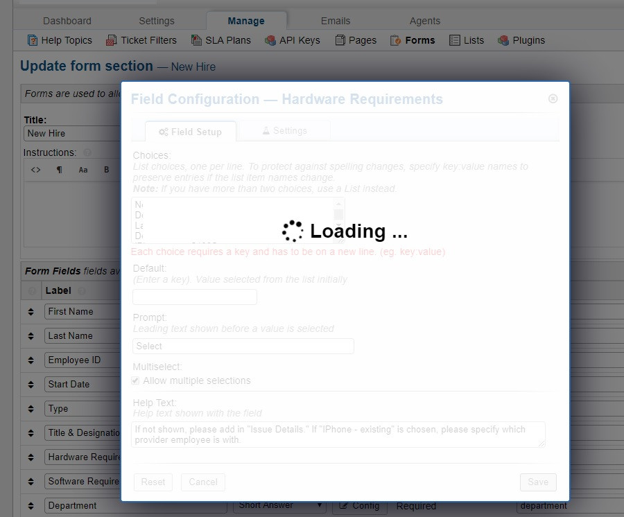

I did see that error and confirm that each entry is on a separate line. I have this issue even when I have one line listed:

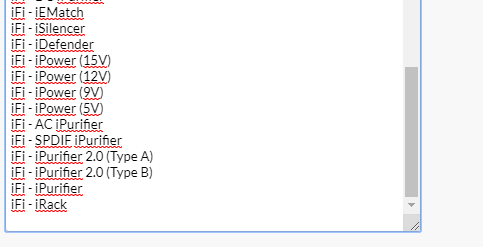

I have this same problem for our company:
If we press save it will just keep on 'loading' - Tried to remove and make changes but still no luck.
Thanks.
ifiaudio_OD You have iFi - someWord iFi - anotherWord ....
and it should be 1:someWord 2:anotherWord .....
