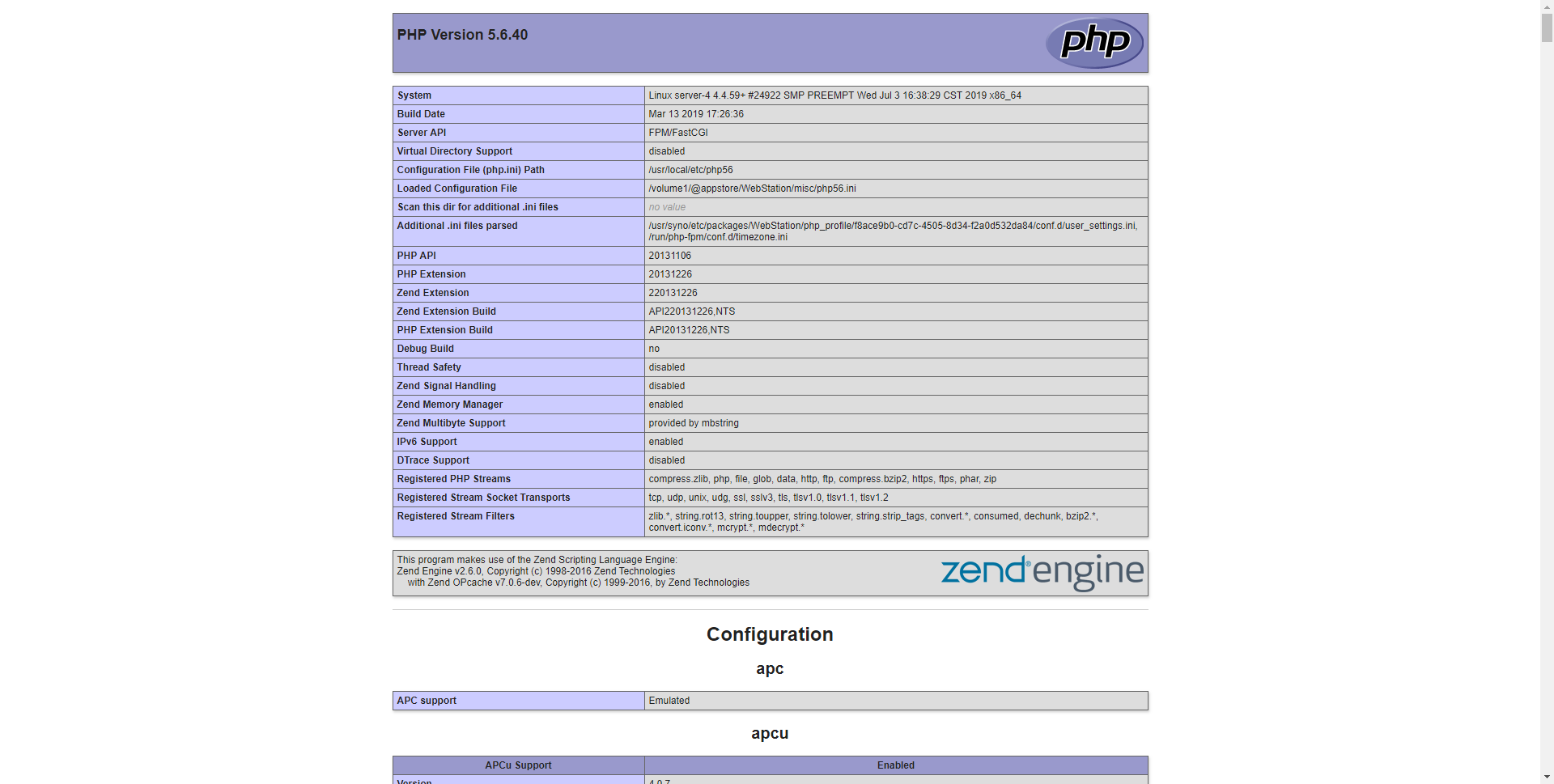

FloF Current issues aside, osTicket 1.12.x works better with PHP 7.x so if you're going to fix a problem, your efforts might as well be spent on PHP 7.2. If you remove 5.6 first, then install a fresh copy of 7.2 you should see the updated version and configuration file in your phpinfo. If not, then it's the Apache config that'll need looked at.
I admit I've never seen an issue with different versions of PHP causing errors (they can usually quite happily coexist), although I'm not familiar with Synology DSM either to be honest.
