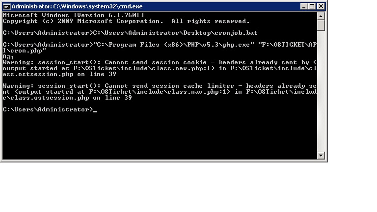

I am trying to either change or remove the support home, and create new tickets from the nav links. I did successfully do both and they worked, however when I edit class.nav.php the external links work, butmy batch file running cron.php generates errors. after replacing with the original everything is fine.
error message attached
Any advice?
