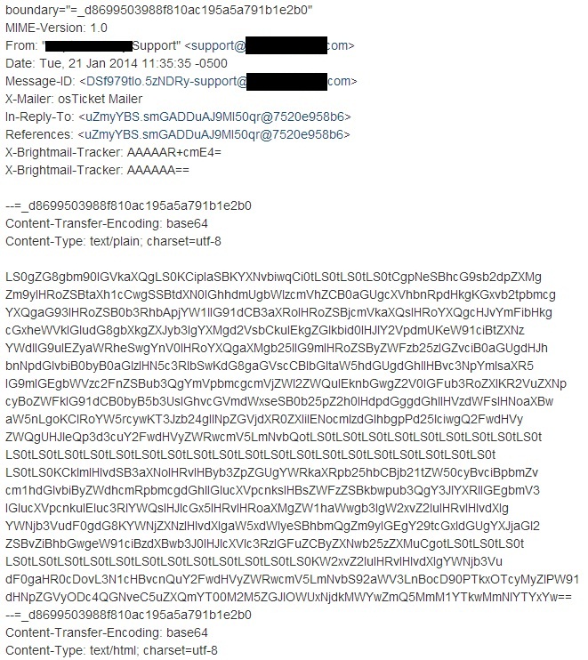

Using v 1.8.0.1I've had one customer today tell me the e-mail they received yesterday as a reply had no content, and another send me this back to show what he received....I'm at a loss to explain this as it was working fine during testing and others seem to be receiving the e-mails fine...I cant paste the gibberish example because the forum then tells me the body is X characters too long, so here's a screencap.
For the record, the templates all look fine. I've asked one of the customers what client they use and am awaiting a reply. In the meantime, it appears the attachment I added didn't upload, so here's the screencap:

Seems like Outlook is the common thread in these cases. Not terribly surprising that MS's e-mail has the standards compliance their browser had as of IE7 or so...I will report back once I find out what client these two are using.
As a side note we use Outlook 2007 and 2013 here in house and have not had this problem reported to us.
Customer reported using outlook 2010, I could not reproduce on outlook 2013 and 2007 either, but the client confirmed it was working when I switched from php mail to smtp in the config.
Hm. Yeah, my customer just replied and said he is using Windows 8 with Outlook as his client. I'll have to check into the SMTP setup.
