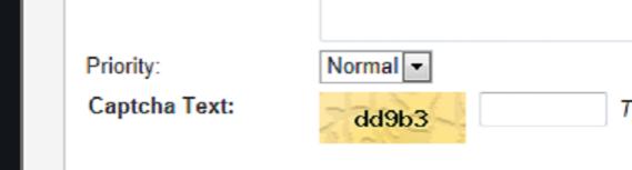

Hi, I to was perplexed with the sensitivity of the captcha codes and in the forum I found a way to make the code lower case (which most users use) but still needed to have a warning declaring that the captcha was case sensitive.
