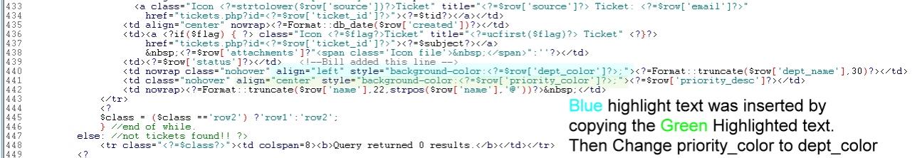

Within \include\staff\tickets.inc.php
around line 440 find line that contains truncate($row
Modify this line...Add similiar code like that used for priority
<td nowrap class="nohover" align="left" style="background-color:<?=$row?>;"><?=Format:($row,30)?></td>
