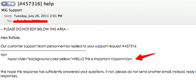

I installed the editor and modified the codes. All works fine except that the reply that goes out is in text format with bunch of HTML codes.

Please see the image of the Email that came through with HTML codes. Of course, you can see my reply as well.
Im unsure if I can help with the email, but I can (kinda) guide you in the right direction..
open up include/staff/viewticket.inc.php
find this code...
<?=Format:($resp_row)?>replace it with this code...
<?php
$doc = new DOMDocument();
$doc->loadHTML(($resp_row));
echo $doc->saveHTML();
?>Now you have the CKEditor HTML output being parsed by PHP's DOMDocument(). There is probably a way to make this work system wide. +1 for who ever figures it out.

BTW, I had to add the and tags to the database entry myself, the editor did NOT enter the HTML into the database. I'm looking to figure this one out now.....
Ok php was stripping out the tags and not inserting them into the db.
in class.ticket.php
Find this code...
$sql= 'INSERT INTO '.TICKET_RESPONSE_TABLE.' SET created=NOW() '.
',ticket_id='.db_input($this->getId()).
',msg_id='.db_input($msgid).
',response='.db_input(Format:($response)).
',staff_id='.db_input($thisuser->getId()).
',staff_name='.db_input($thisuser->getName()).
',ip_address='.db_input($thisuser->getIP());
$resp_id=0;
replace the "response" line with...
',response='.db_input($response).
Booyah. I would be VERY careful about allowing this into your client front end...DomDocument parses whatever you (or your client) throws at it. : You have been warned. :
