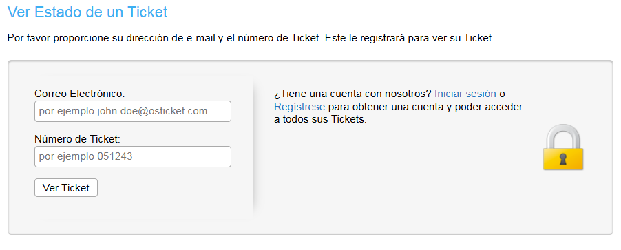

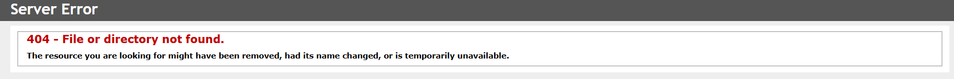

Now, I have automated response templates that are sent to users when a ticket is answered. Lately, users have been telling me that when they click on the hyperlinks in the responses to view the entire ticket thread, they get a 404 not found error or are asked for a username and password to view the thread. Otherwise, they are asked for their email address and ticket number to access the thread. This did not happen on other occasions. I will attach images:

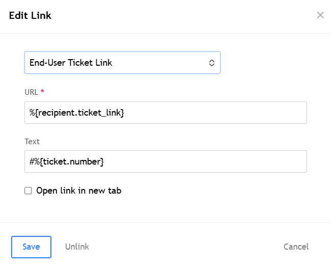

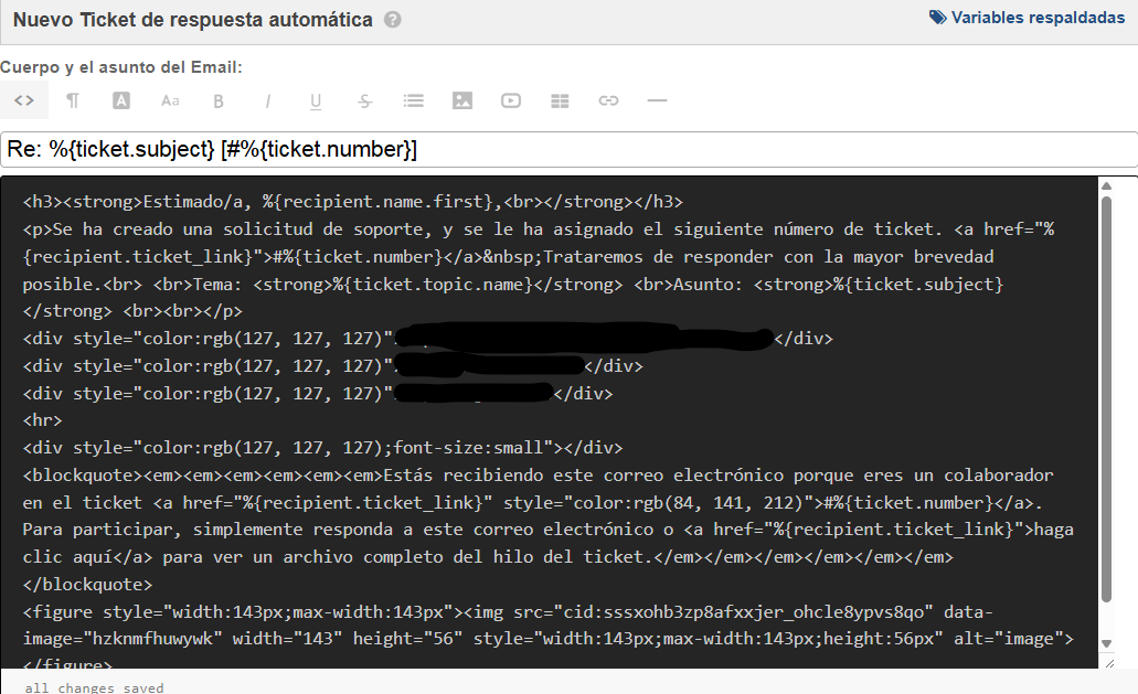

I have reviewed the configuration of the forms and links. In principle, I understand that I am entering the correct links, as I am entering the one that refers to End-User Ticket Link. I am attaching images of both the configuration and the HTML of the template:
I have covered up some information due to confidentiality issues, but it is not related to the HTML code.
I understand that based on this configuration, the links associated with the words should allow end users to view the ticket threads.
