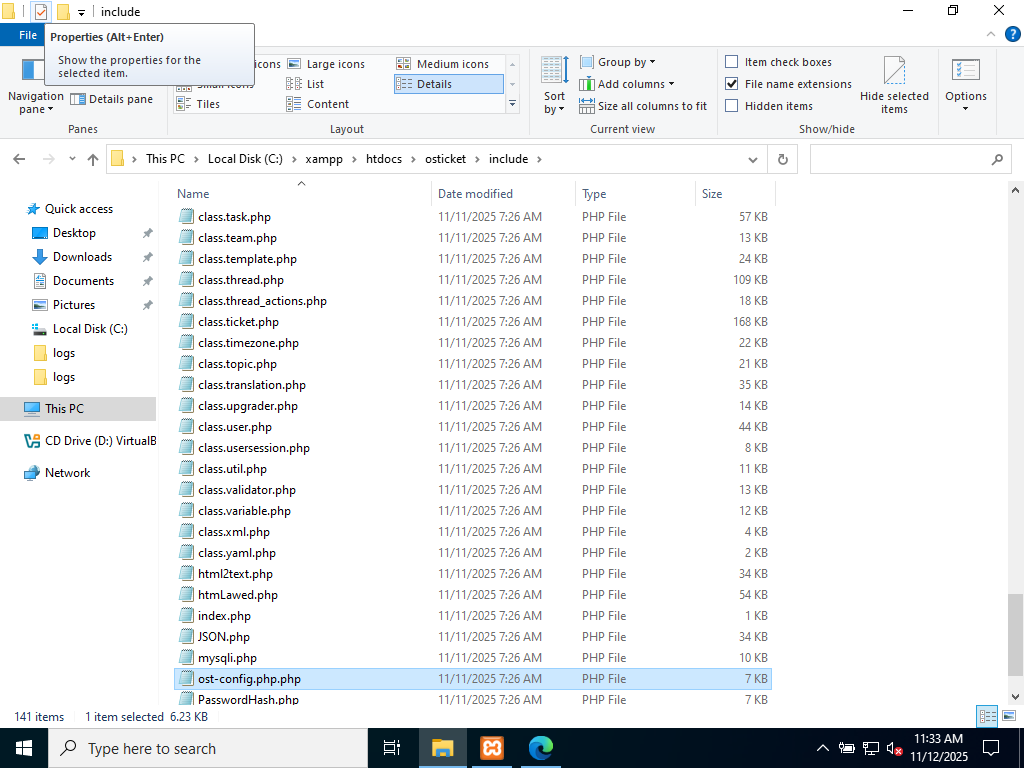

Discovery:
On file explorer, clicked on View then ticked File name extension. I discovered the file ost-config was labelled ost-config.php.php
Solution:
Took .php off and left it as ost-config. This worked
