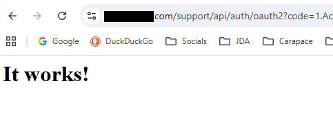

The fellow was adding a /http.php/ value to the response from adding OAuth2 Microsoft into the browser, so he was updating the redirect to: https://domain.com/api/http.php/etc///
Setting the [R,L] in /api/.htaccess allowed me to see the actual issue:
