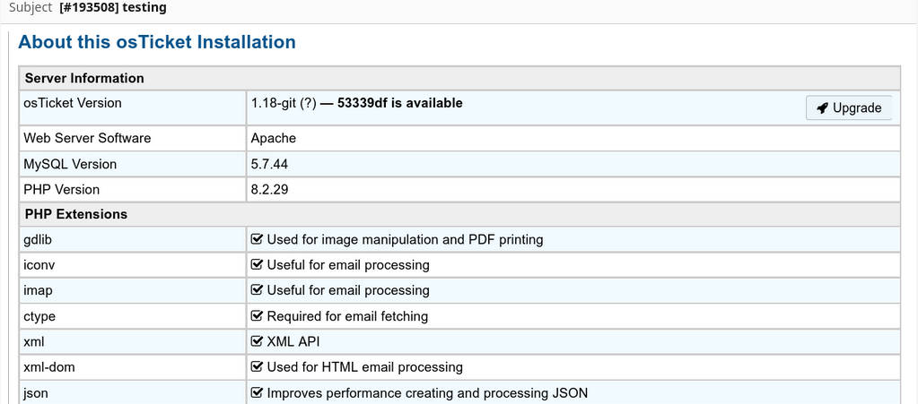

OK, that makes sense. I indeed used git directly, oops. Sorry about that.
I now downloaded the official 1.18.2 release and dropped it in. No upgrade is possible b/c I was aleady on 1.18 it seems.
Anyhow, now Gmail works but Thunderbird still does not.
You can use a git clone; if you do then use the actual tagged release of v1.18.2. If you go that route then for good measure use the cli deploy command to properly deploy the code to the designated site folder. You can find this information within the repo’s README.

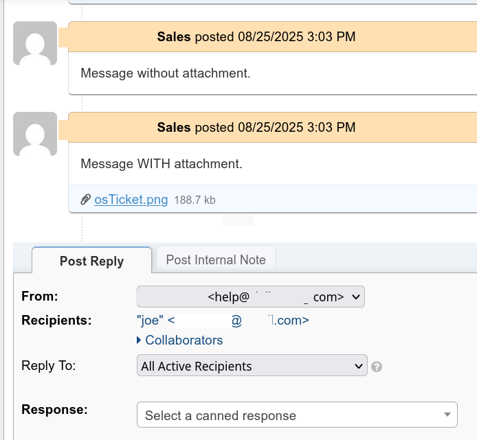

Here is how it looks in OsTicket:

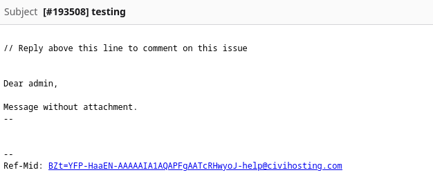

Here in Thunderbird with no attachment, looks fine:

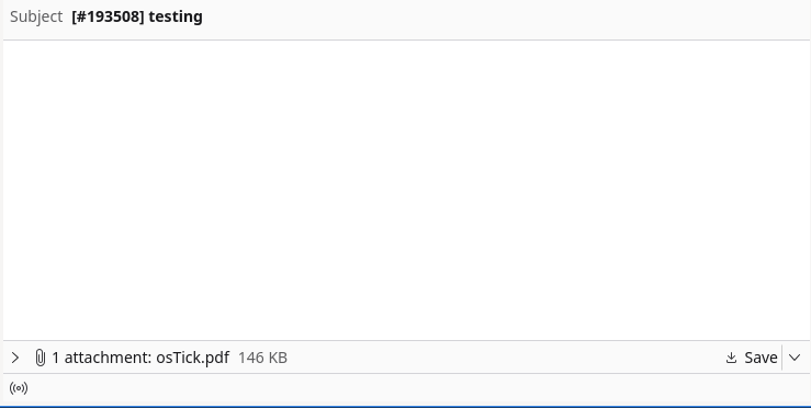

Here with PDF attachment, it comes out attached, but no body text:
