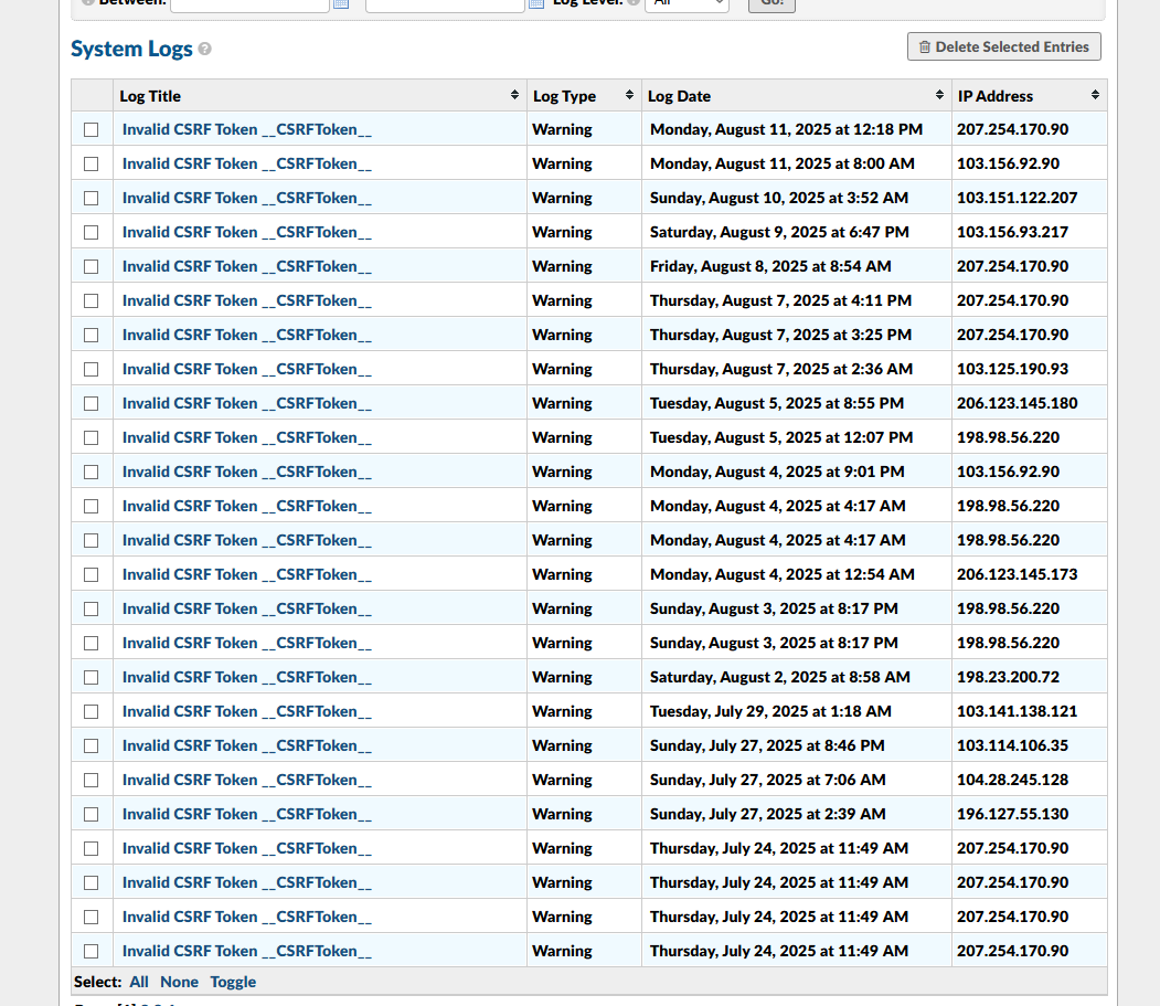

Not sure how to fix this. I normally have to just delete my cookies for the site to get logged in. Otherwise it gets stuck in a "signed out after inactivity" state.
