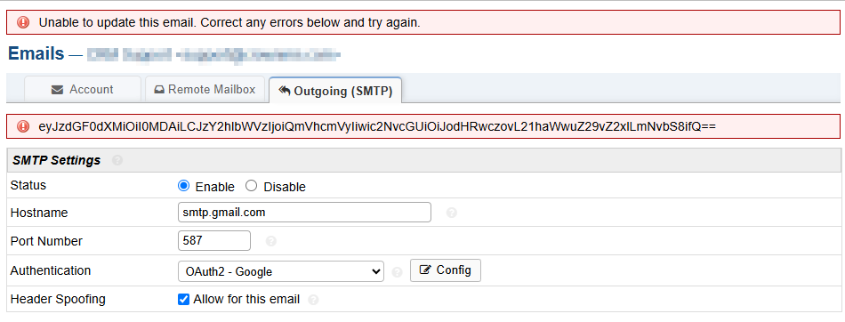

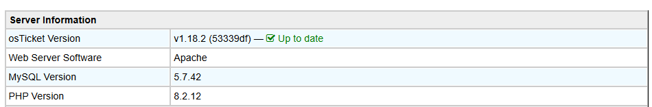

We are in the process of configuring Gmail SMTP with OAuth2 in osTicket v1.18.2 (53339df) and have run into an issue we’re hoping to get help with.
Configuration Details:
OAuth2 Setup: Completed in Google Cloud Console (Client ID, Secret, scopes, etc.)

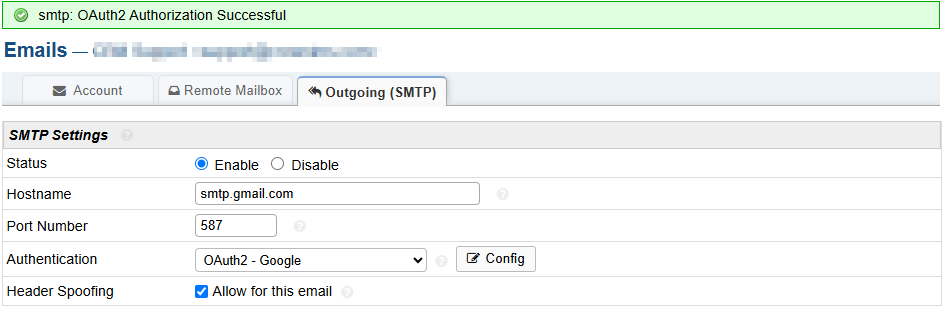

Authorization: Succeeds during the OAuth2 flow and returns "Authorization Successful"

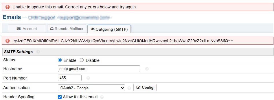

However, when we attempt to save the email settings after this successful authorization, the system throws the following error message:
eyJzdGF0dXMiOiI0MDAiLCJzY2hlbWVzIjoiQmVhcmVyIiwic2NvcGUiOiJodHRwczovL21haWwuZ29vZ2xlLmNvbS8ifQ==

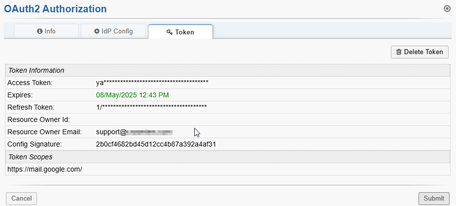

Scopes configured include: https://mail.google.com/
OAuth2 flow completes correctly – token is retrieved and stored.

Decoding the Error:
When base64-decoding the message:
"status": "400",
"schemes": "Bearer",
"scope": "https://mail.google.com/"
This suggests a 400 Bad Request is being returned by Gmail’s SMTP endpoint when osTicket tries to validate or send via SMTP.

Environment: Windows
