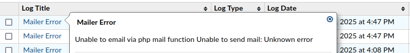

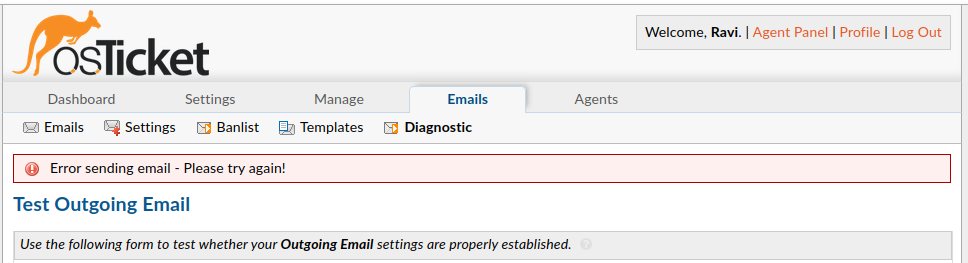

I'm facing an issue with outgoing emails in osTicket v1.17-rc2 (d821546). When trying to send a test email, I get the following error message:
🚨 "Error sending email - Please try again!"
/var/logs/apache2/error.log
sh: 1: /usr/sbin/sendmail: not found

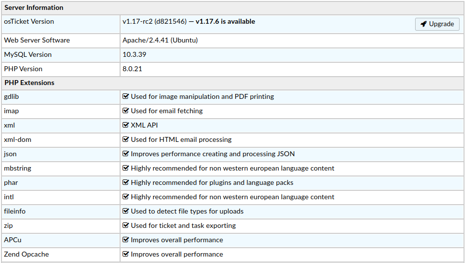

✔ Enabled SMTP Debugging in osTicket
✔ Checked the server error logs but no clear issues
✔ Verified that the Client ID and Client Secret are correct
✔ Tried reloading the page, but still blank
