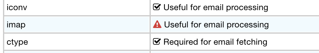

      As of v1.18.2 it is still showing required or at least strongly recommended. Is this just something that needs to be removed in the next version or what?
        SteffanCline
        The wording was changed from “Required for email fetching” to “Useful for email processing”. It’s not needed anymore; it’s only helpful in some situations.
