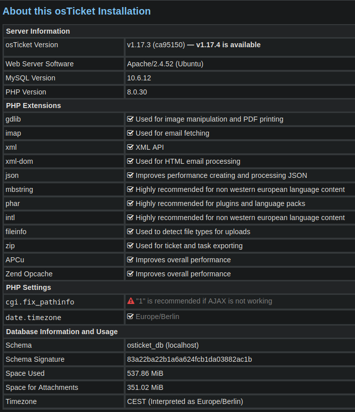

Information about my installation:
Server: Ubuntu 22.04.3 LTS x86_64
osTicket: v1.17.3 (ca95150)
PHP -V: PHP 8.0.30 (cli) (built: Sep 2 2023 08:05:13) ( NTS ) | Zend Engine v4.0.30
web server: Apache/2.4.52 (Ubuntu)
MySQL: 10.6.12
More see image below
