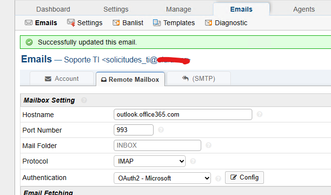

https://docs.osticket.com/en/latest/Getting%20Started/Email%20Settings.html

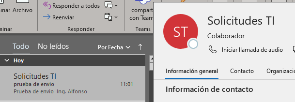

I already configured the input as imap, however when I send a message from my outlook mailbox to solicitudes_ti@xxxx it does not generate the ticket in the osticket mailbox.

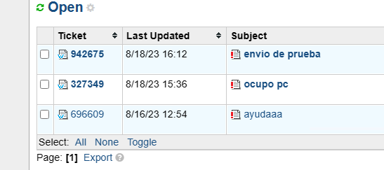

You need to enable email fetching globally and setup a Cron Job:
How do I configure the job?
That information is listed in the link I provided above.
resolved. tanks.
