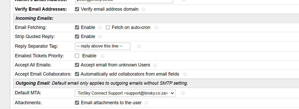

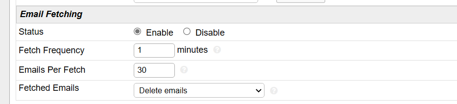

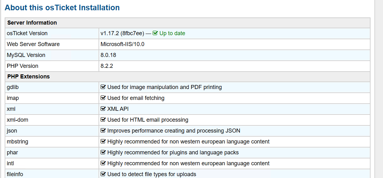

So i downloaded PHP 8.1 and started from scratch...everything has been setup as it should be, i believe but still when i remove autoCron i am not receiving emails when logged with support (Not receiving emails on the agent panel and not receiving an automatic ticket number and reponse etc...
When i enable "Fetch on autCron" then i get the emails logged with support and they are seen from the dashboard etc...but when removed "Fetch on AutoCron" i get nothing..

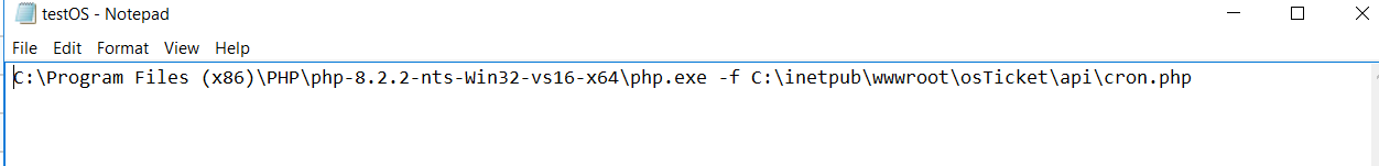

i have tried running my bat file but nothing...
PHP error logs:
[13-Feb-2023 10:14:15 UTC] PHP Warning: PHP Startup: Unable to load dynamic library 'php_gd2.dll' (tried: C:\Program Files (x86)\PHP\php-8.1.15-nts-Win32-vs16-x64\ext\php_gd2.dll (The specified module could not be found), C:\Program Files (x86)\PHP\php-8.1.15-nts-Win32-vs16-x64\ext\php_php_gd2.dll.dll (The specified module could not be found)) in Unknown on line 0
[13-Feb-2023 10:14:15 UTC] PHP Warning: PHP Startup: Unable to load dynamic library 'php_xmlrpc.dll' (tried: C:\Program Files (x86)\PHP\php-8.1.15-nts-Win32-vs16-x64\ext\php_xmlrpc.dll (The specified module could not be found), C:\Program Files (x86)\PHP\php-8.1.15-nts-Win32-vs16-x64\ext\php_php_xmlrpc.dll.dll (The specified module could not be found)) in Unknown on line 0
[13-Feb-2023 10:25:35 UTC] PHP Warning: PHP Startup: Unable to load dynamic library 'php_gd2.dll' (tried: C:\Program Files (x86)\PHP\php-8.1.15-nts-Win32-vs16-x64\ext\php_gd2.dll (The specified module could not be found), C:\Program Files (x86)\PHP\php-8.1.15-nts-Win32-vs16-x64\ext\php_php_gd2.dll.dll (The specified module could not be found)) in Unknown on line 0
[13-Feb-2023 10:25:35 UTC] PHP Warning: PHP Startup: Unable to load dynamic library 'php_xmlrpc.dll' (tried: C:\Program Files (x86)\PHP\php-8.1.15-nts-Win32-vs16-x64\ext\php_xmlrpc.dll (The specified module could not be found), C:\Program Files (x86)\PHP\php-8.1.15-nts-Win32-vs16-x64\ext\php_php_xmlrpc.dll.dll (The specified module could not be found)) in Unknown on line 0
[13-Feb-2023 10:26:26 UTC] PHP Warning: PHP Startup: Unable to load dynamic library 'php_gd2.dll' (tried: C:\Program Files (x86)\PHP\php-8.1.15-nts-Win32-vs16-x64\ext\php_gd2.dll (The specified module could not be found), C:\Program Files (x86)\PHP\php-8.1.15-nts-Win32-vs16-x64\ext\php_php_gd2.dll.dll (The specified module could not be found)) in Unknown on line 0
[13-Feb-2023 10:26:26 UTC] PHP Warning: PHP Startup: Unable to load dynamic library 'php_xmlrpc.dll' (tried: C:\Program Files (x86)\PHP\php-8.1.15-nts-Win32-vs16-x64\ext\php_xmlrpc.dll (The specified module could not be found), C:\Program Files (x86)\PHP\php-8.1.15-nts-Win32-vs16-x64\ext\php_php_xmlrpc.dll.dll (The specified module could not be found)) in Unknown on line 0
[13-Feb-2023 10:27:34 UTC] PHP Warning: PHP Startup: Unable to load dynamic library 'php_gd2.dll' (tried: C:\Program Files (x86)\PHP\php-8.1.15-nts-Win32-vs16-x64\ext\php_gd2.dll (The specified module could not be found), C:\Program Files (x86)\PHP\php-8.1.15-nts-Win32-vs16-x64\ext\php_php_gd2.dll.dll (The specified module could not be found)) in Unknown on line 0
[13-Feb-2023 10:27:34 UTC] PHP Warning: PHP Startup: Unable to load dynamic library 'php_xmlrpc.dll' (tried: C:\Program Files (x86)\PHP\php-8.1.15-nts-Win32-vs16-x64\ext\php_xmlrpc.dll (The specified module could not be found), C:\Program Files (x86)\PHP\php-8.1.15-nts-Win32-vs16-x64\ext\php_php_xmlrpc.dll.dll (The specified module could not be found)) in Unknown on line 0
[13-Feb-2023 10:27:34 UTC] PHP Warning: PHP Startup: Invalid library (appears to be a Zend Extension, try loading using zend_extension=php_opcache.dll from php.ini) in Unknown on line 0
[13-Feb-2023 10:27:47 UTC] PHP Warning: PHP Startup: Unable to load dynamic library 'php_gd2.dll' (tried: C:\Program Files (x86)\PHP\php-8.1.15-nts-Win32-vs16-x64\ext\php_gd2.dll (The specified module could not be found), C:\Program Files (x86)\PHP\php-8.1.15-nts-Win32-vs16-x64\ext\php_php_gd2.dll.dll (The specified module could not be found)) in Unknown on line 0
[13-Feb-2023 10:27:47 UTC] PHP Warning: PHP Startup: Unable to load dynamic library 'php_xmlrpc.dll' (tried: C:\Program Files (x86)\PHP\php-8.1.15-nts-Win32-vs16-x64\ext\php_xmlrpc.dll (The specified module could not be found), C:\Program Files (x86)\PHP\php-8.1.15-nts-Win32-vs16-x64\ext\php_php_xmlrpc.dll.dll (The specified module could not be found)) in Unknown on line 0
[13-Feb-2023 10:27:47 UTC] PHP Warning: PHP Startup: Invalid library (appears to be a Zend Extension, try loading using zend_extension=php_opcache.dll from php.ini) in Unknown on line 0
[13-Feb-2023 10:33:04 UTC] PHP Warning: PHP Startup: Unable to load dynamic library 'php_gd2.dll' (tried: C:\Program Files (x86)\PHP\php-8.1.15-nts-Win32-vs16-x64\ext\php_gd2.dll (The specified module could not be found), C:\Program Files (x86)\PHP\php-8.1.15-nts-Win32-vs16-x64\ext\php_php_gd2.dll.dll (The specified module could not be found)) in Unknown on line 0
[13-Feb-2023 10:33:04 UTC] PHP Warning: PHP Startup: Unable to load dynamic library 'php_xmlrpc.dll' (tried: C:\Program Files (x86)\PHP\php-8.1.15-nts-Win32-vs16-x64\ext\php_xmlrpc.dll (The specified module could not be found), C:\Program Files (x86)\PHP\php-8.1.15-nts-Win32-vs16-x64\ext\php_php_xmlrpc.dll.dll (The specified module could not be found)) in Unknown on line 0
[13-Feb-2023 10:33:04 UTC] PHP Warning: PHP Startup: Invalid library (appears to be a Zend Extension, try loading using zend_extension=php_opcache.dll from php.ini) in Unknown on line 0
