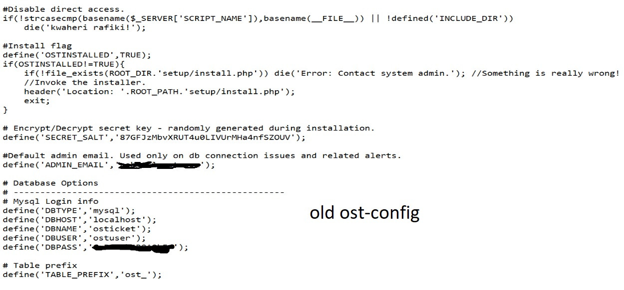

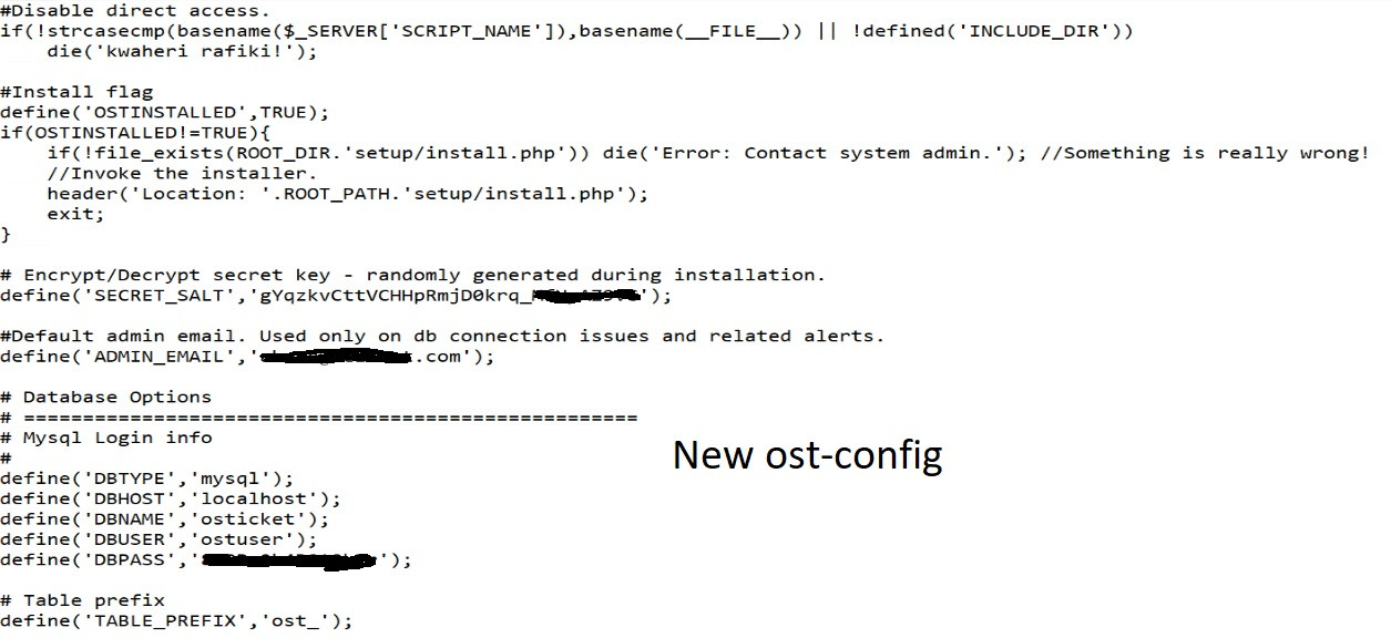

all of the database info except "secret_salt" key is same on both new and new ost file as you can see in the pictures please let me know if i am doing something wrong.
Right, on the new server do you have a database named osticket and a MySQL user by the name of ostuser with access to the osticket database?
osticket
ostuser
yes i do

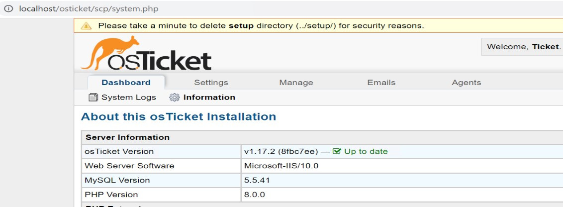

if i am just replacing the old ost-config file with the new file without merging the old database to new one i can login to admin panel but its just like a new instance and not giving me the upgrading option in the Dashboard>information as described in the documentations and as soon as i will merge the old database to new one it starts giving the error the site cannot be reached
Right because it’s a new install. You can now migrate the database to the new server, update the config to point to that database, then you can upgrade.
