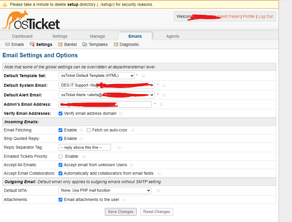

Do you have a cron job setup and running? If so, is it running the correct PHP version? Do you have Email Fetching enabled globally (Admin Panel > Emails > Settings > Email Fetching)?
Hi Kevin, thanks for the reply
Cron job is not activated, since it was not activated on your "old" solution.
Email Fetching was somehow not activated, it its now but still no emails being fetched
