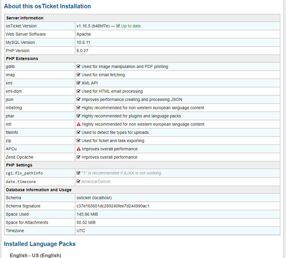

    Where did you download the plugin from? Also, please post a screenshot of Admin Panel > Dashboard > Information.

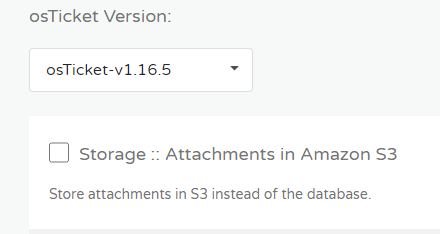

      Did you select the correct version of osTicket before selecting the plugin for download? Plugins these days are specific to the core version of osTicket. So on the Plugin download page make sure you select osTicket-v1.16.5 first.

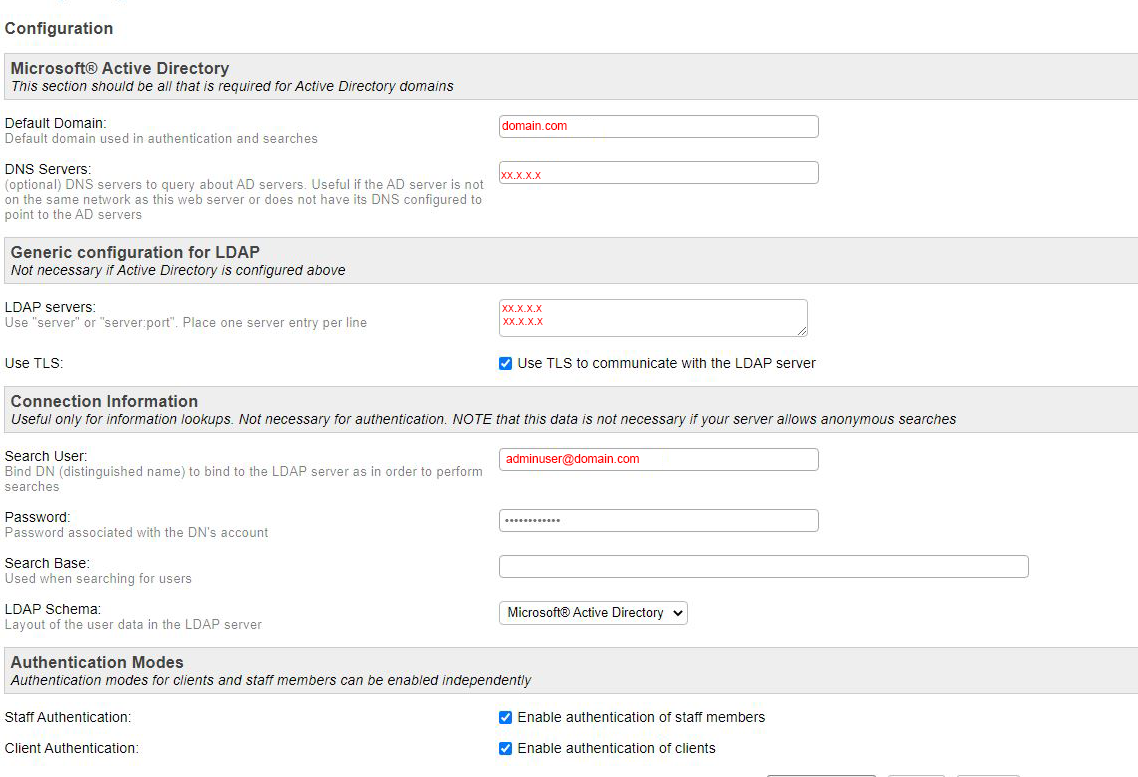

        Okay, can you post a screenshot of the plugin config? Censor any sensitive info before posting.

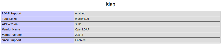

          Also, did you make sure you installed and enabled the php-ldap extension for PHP 8.0?

          Here it is:
          If I select save as is I get a 5oo error shown above. If I deselect the "Use TLS to communicate with the LDAP server." it saves without issue but the authentication does not work.
          I do have ldap enabled

                  Potentially, but doubt it. The only time it doesn't work is when using TLS right? Otherwise it works fine?
                    KevinTheJedi
                    That's correct. I think it might be import to note I do have some applications on that server that use LDAP/AD authentication that are working without issue.
