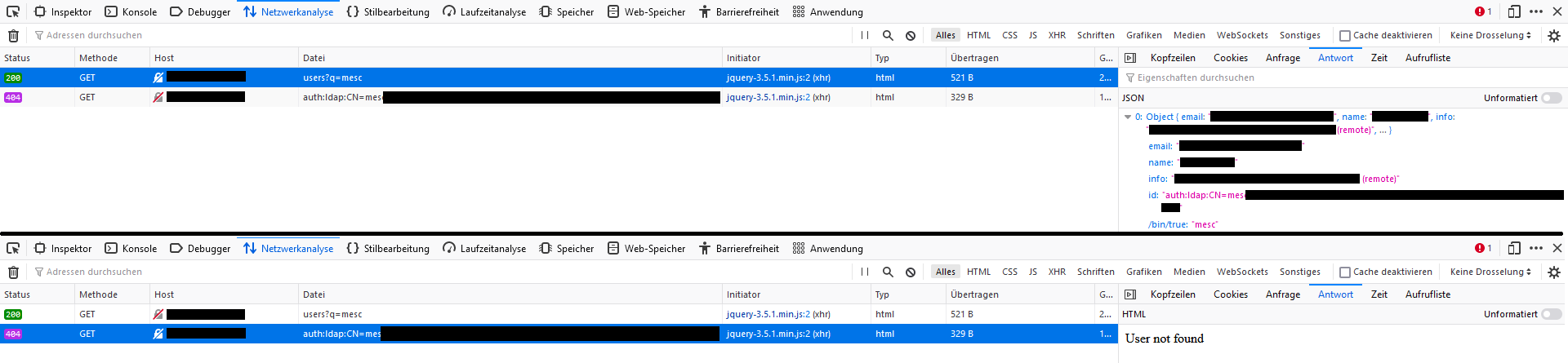

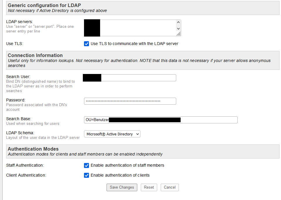

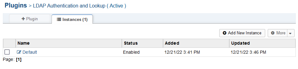

i went for a 1.16 install because i couldn't get LDAP lookup to work in 1.17, but now i made a clean test install to look more into it. Basically my problem is that while the actual LDAP search works when trying to add a user, thats all. When i click on the name, nothing happens and i get a 404 in the console. It works perfectly fine for agents. Fresh install: Plugins: Instance: LDAP Config: Here is a screenshot of the networkanalysis from the browser. First half is the response from the search, the second half is the response from clicking on the actual name:

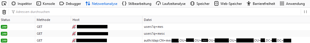

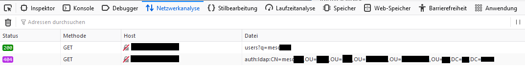

404 is Not Found which means whatever path you are calling on the webserver doesn't exist. What is the full URL path it's trying to call when clicking the result from the lookup?
KevinTheJedi It's trying to call the distringuished name of the user. I only cencored all the OU names itself this time: However, this is what it looks like on my 1.16 install...

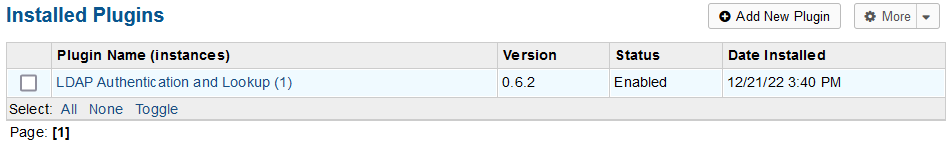

Sounds like you need this:
KevinTheJedi Is this still relevant despite me only having one instance? (See my original post about the Plugins and Instance, you can see i only have one instance of the LDAP Plugin)

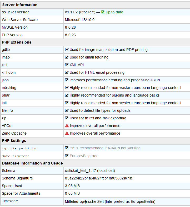

You can but I will say that I have no issues with v1.17.2, the latest LDAP plugin, PHP 8.1, and Apache.
You can try making these changes manually and retest:
KevinTheJedi I'll give 8.1 a try then.
