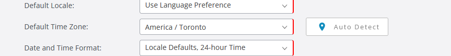

Osticket timezone : America/Toronto

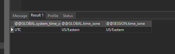

Mysql timezone : (There is no America/Toronto in AWS RDS, so I use the US/Eastern)
And I end up with that osticket is using SYSTEM timezone? The time when i create a new ticket is the UTC one. (The mysql system timezone which cannot be changed on AWS).
