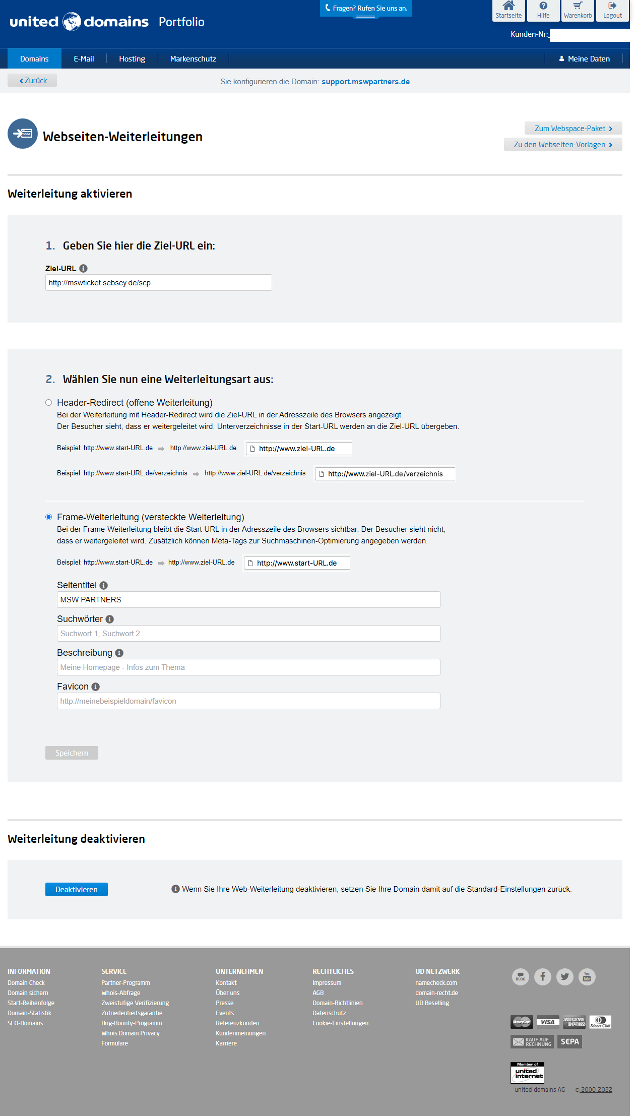

The following problem: I cannot log in after a frame forwarding (hidden forwarding), so a login looping happens in the employee area /scp (permanently "login required"). If I run the ticket system directly at the host, it works.
Facts:
Ticket system is hosted here: mswticket.sebsey.de
But the call should be made via support.mswpartners.de.
This domain is registered with United Domains. Here I set up a forwarding to http://mswticket.sebsey.de as a frame forwarding (hidden forwarding) directly in the config portal. The forwarding also works, the configuration within the ticket system (allow iFrame http://support.mswpartners.de,support.mswpartners.de,mswpartners.de,mswpartners.de is stored in this way).
An open forwarding does not bring the login loop problems!
However, I would like the domain bar to continue to show support.mswpartners.de instead of mswticket.sebsey.de.
I've tried so many things and tried to read up on the internet, but I just can't do it. I will also post various screenshots of my configuration.

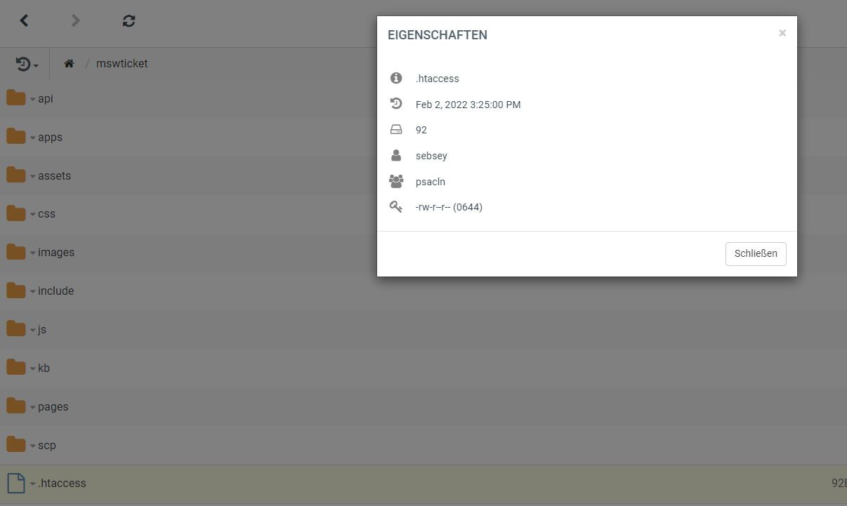

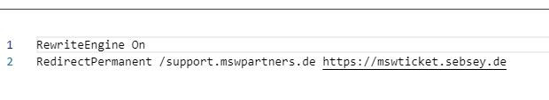

I assume there is the problem. I also tried to solve it with an .htaccess, but I am not familiar with it.

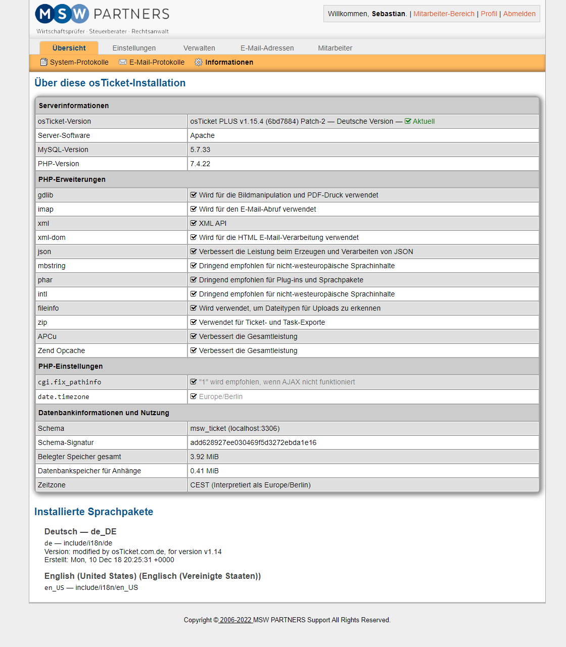

INFORMATION:
Serverinformationen
osTicket-Version osTicket PLUS v1.15.4 (6bd7884) Patch-2 — Deutsche Version — Aktuell
Server-Software Apache
MySQL-Version 5.7.33
PHP-Version 7.4.22
