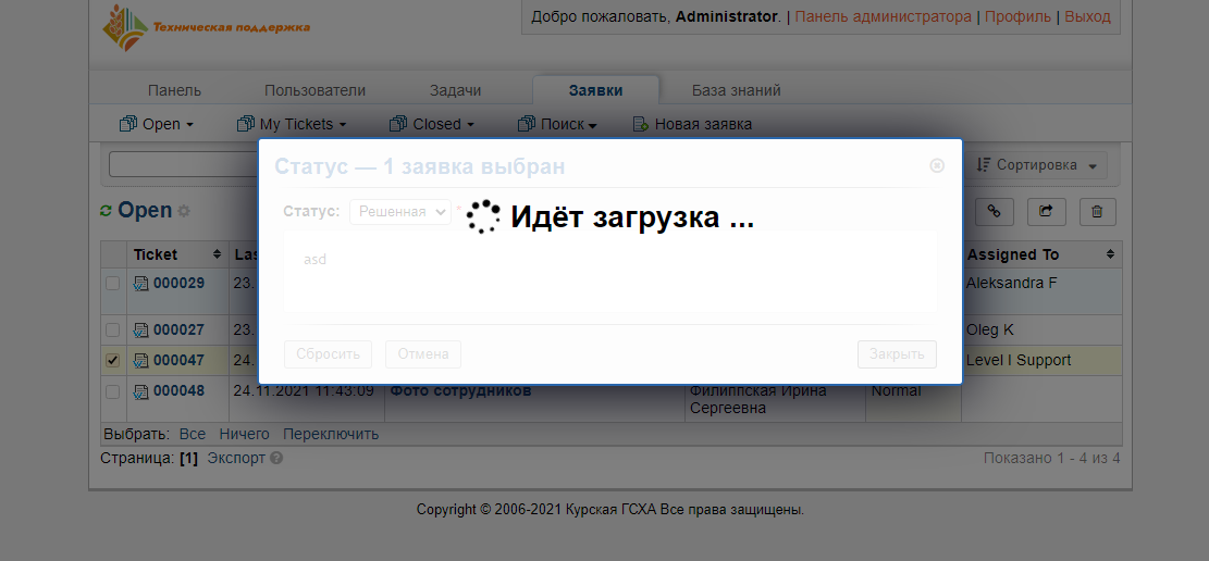

Same issue if admin or agent. Chrome or Firefox makes no difference.

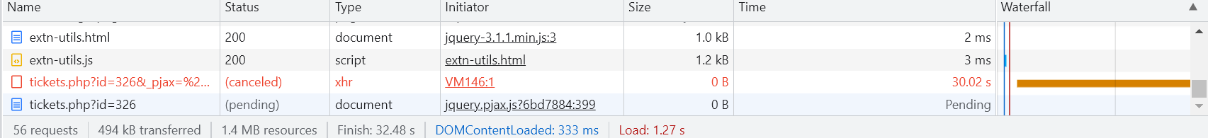

It after a long time goes just back to open tickets
I also cant create new tickets. Goes into infinte loading and then into http error 500.
I installed a new clean version in a new subdomain
And I face exact same behaviour.

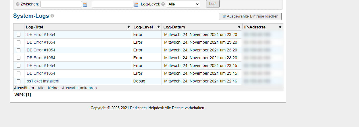

Here compared to the other system i can see some DB errors:
[INSERT INTO ost2_user__cdata SET notes='', user_id= 3 ON DUPLICATE KEY UPDATE notes=''] Unknown column 'notes' in 'field list'
---- Ablaufverfolgung ----
#0 (root)/include/mysqli.php(201): osTicket->logDBError('DB Error #1054', '[INSERT INTO o...')
#1 (root)/include/class.dynamic_forms.php(381): db_query('INSERT INTOos...')
